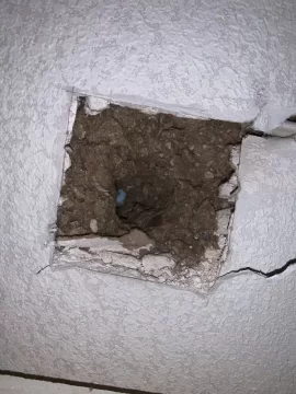

It's a built-in cabinet upstairs., and there are some squares of previously cut drywall that I removed to take a picture. There's the old insulation, and I dug through it with a finger to find a blue layer between the insulation and the brick (exterior fireplace brick facing the home).
The brownish insulation may be a blown in type which normally would not allow much air to flow.
The blue insulation is probably a foam board which will burn hot with enough air flow.
You can put a panel over the drywall to cover the hole after investigating.
Before spending 900 on lining the smoke chamber, I would enlarge the hole to 12" square and remove the insulation to get back to the brick. If there is a crack thru the brick work, I would want to find it and determine why it happened.
I don't know if a "ceramic coating" can bridge a crack that is subject to heating and cooling and possibly still moving.
