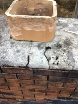

I'm definitely going to have the cap repaired immediately and have a few mortar joints tuck pointed and waterproofing applied.

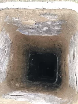

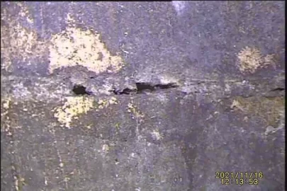

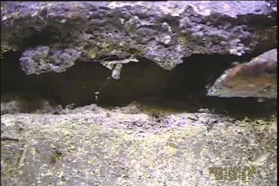

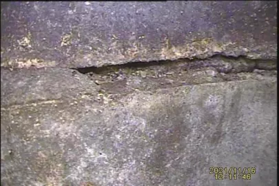

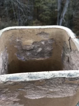

I am attempting to post some of the pics the sweep sent with inspection report and estimates. Pics from inside the flue are of the open fireplace on main level. Of the two, that is supposedly the better condition flue. I say supposedly bc we didn't run a camera through it.
c89c3e81-84c3-430e-b0f4-7c6448dd5923_cdv_photo_009.jpg f5a4cce1-5a66-429e-9c45-4f9be650923d_cdv_photo_001.jpg f0f49a8a-4424-45d9-b302-1d7fd93159f8_cdv_photo_005.jpg af2f9ac7-5581-4f31-801a-5670c85d5f49_cdv_photo_014.jpg 33b34075-eda8-45ac-bc9d-d3e2a216610a_cdv_photo_001.jpg d1568425-deb1-489d-a765-102a4c169641_cdv_photo_008.jpg

There are 3 types of insert installs.
Slammer: Insert just thrown into a fireplace. (cheap, easy, but bad and almost uncleanable with out removing the insert)
Direct connect: Insert thrown into a fireplace with a stub of chimney going into the chimney with a blockoff plate to keep side draft down and reverse draft from killing you.(Again cheap, less easy and again bad. Very hard to clean. Draft is not great.)
Full install: Insert is installed into a fireplace with a full stainless liner from stove to cap.(More expensive, depending on the chimney can be hard to install or easy, draft is good, and usually easy to clean.)

You are getting good and timely advice. Did the new stainless liner include insulation? It must be insulated.
