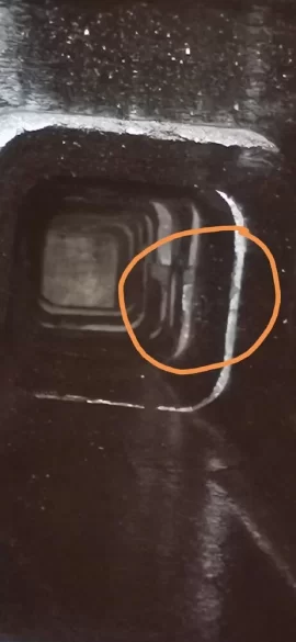

Hi there. I have a similar situation in the flue of my 1978 house. I don't know if I should trust the old school people that swear that wear and tear are normal or "professional" that barely knows how old chimney are made but want to sell and upgrade everything, especially with the stainless steel liner. Did you make an opinion about the conditon of your flue? I have attached a picture showing how mine looks. I can pass some fingers through the closest junction.

That glaze of creosote is going to build up in those cracks. If that catches fire you could lose your house, or even worse, your family.
You can break out those tiles and install your own liner.
