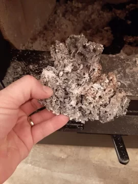

Hi there, first post on this site! First clean out of my wood burning insert revealed these beauties. From what I've read, they're called clinkers.
[Hearth.com] Are Hard ash / clinkers problematic?
I've burnt almost exclusively elm so far this season which had been standing dead for many years.
Are they bad for my catalytic insert?
Is there anything that I use them for?
Sometimes they fuse to the firebrick so when you take them out you lose a chunk of firebrick too.

Clinkers aren't completely abnormal or unheard of. No real use for them that I am aware of! Chuck them out.

Thanks for the comment. It's a regency 2700. With both burn tubes and a cat.
I split it early spring, stacked open in the sun and breeze, so it's been only 6 months. Havent checked the moisture of the logs yet either.
Clinkers are formed from fused silicas that were in the wood. Bark will have the most. They don't affect stove performance.

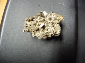

I'm just starting to get these but I put new firebrick and combustors on and I'm finally getting hot enough fires to light them off. I get that it's gonna happen reading posts here but some of it is just impossible to get off the firebrick. It's new brick (I replaced all of it when I installed the combustors) so I really don't want to be breaking it and replacing with more new bricks (too expensive to keep buying new boxes). Any tips on how I might prevent this? Leaving a few inches of ash like Firecat suggests on their combustor FAQ doesn't stop it. FWIW I'm burning all thoroughly seasoned maple (tested with a moisture meter at 7-10%).

I don't know of any way to stop them. It's a characteristic of the wood you are burning. Fwiw I have them every time I empty the ashes and I burn nothing but hickory and oak. I have never had one fused to the firebricks.
Normal. Gently remove the easy stuff with your poker when removing ash, then work around the tuff parts during burning season. Not worth busting fire brick over unless your a finger nail chewer kinda personality;lol
They come from silica in the wood getting fused together. The silica can be concentrated in the bark. They are common. Some wood species create more than others.
I get those when I have a really hot pile of coals on top of ash left by something with bark on it, usually right in front of the air inlets where it'll get blast-furnace hot. Just whatever minerals in there melting together I guess.
Yes I think it was the tree itself. It was a large maple I got for free, I burned through most of it then started on another maple from a different person. The clinkers more or less stopped, but I still occasionally get one. I found another site that referenced a paper about it, it's very thorough (and confusing, and boring). They basically chalk it up to mineral-y wood and hot temps. If the ash has enough mineral content and the fire gets hot, they tested 1400 deg. which is about the max I get when the combustor is on. The ash fuses if there's enough calcium and potassium in the wood. Which makes sense for me because I replaced the old combustors in my stove and probably didn't get a really hot fire for 10 years. And I'm not sure how i works but I would guess the temperature of the large mass of coals, that is what is actually keeping the combustor hot enough to be working, may get hot enough to fuse the ash. They tested several tree species, the only one I burn is oak. They didn't say which one produced the most clinker. At the end they say that more work needs to be done, apparently it's not something that has been studied very much. Their paper focused on large biomass burners, like you see at a lumber mill where they burn the bark and scrap to make steam for the mill. Interesting stuff indeed.
