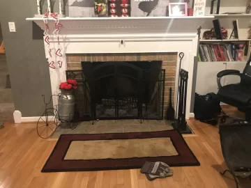

Along the same lines... a question for the forum...
What generates more "heat" in a fireplace... an open fire, or an insert?
I've been running some fires in an open fireplace in my main sitting room, but I'm getting a lot of heat "bleeding through" the adjacent wall of bedroom #1.
I wanted to put an insert into this location (Osburn 3500)... but the amount of heat coming through the bedroom wall is leading me to believe that this might not be possible.
Plan attached, not to scale, but you'll get the idea.

The heat through the wall may be less with an insert (I don't know, but I suspect that). But the total heat in your home will be far more. This is because the fireplace uses a lot more air that it sends up the chimney - and all this air has to be replenished by leaking in thru the outer shell of your home. And that's cold air.

Right now my focus is on trying to determine if the current fireplace is safe to move forward with, not really sure how to do that without punching holes in walls and trying to figure out how it was constructed.
I'm gonna circle back with the company that I'm working with on the insert, given the amount of heat bleading through the "back of the fireplace" into the bedroom wall... I don't feel comfortable burning anything in the current fireplace.

Yes an insert is safer than a traditional fireplace in all regards. The chances of a hot ember flying out are nil. An insert will burn cleaner, hence less chance of a chimney fire. A modern insert with proper operation will be 10x safer than a regular fireplace (my figures)
With regard to your floor plan, an insert will result in significant heat and energy savings, depending on how often you burn. If you plan on occasional fires (ambience, holidays, special occasions) then stick with the fireplace, costs for an insert would not be justified. If you plan on burning all winter, then go with the insert. Your residual heat into the bedroom is nice, but the insert can do the same. Your floor plan looks challenging to get the heat back to the bedrooms, a fan on the floor in the hallway will move cold air towards the fireplace. If bedroom #1 is used alot and us wish to warm it with the insert heat, then a thru-the wall transfer fan can move cold air out or warm air in. Just keep in mind that air displacement requires an in-source and out-source (have to replace the moved air). Closed bedroom doors will prevent warm air from entering.
