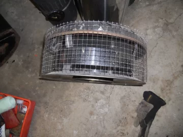

Here are a few pictures
Not in bad shape at all. It's EPA or at least close to it.....

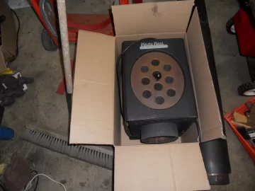

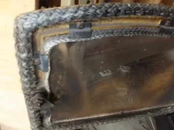

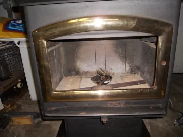

Well I did buy it. It was made in 96 so says the sticker on the back. Here are some pictures of the package deal. I did clean up the brass door myself and pulled the old gaskets and glass.
[Hearth.com] Arrow stoves, any good? [Hearth.com] Arrow stoves, any good? [Hearth.com] Arrow stoves, any good? [Hearth.com] Arrow stoves, any good? [Hearth.com] Arrow stoves, any good?
I don't think they use it much because of the set-up they had. Magic Heat Reclaimer, leaking gaskets, single wall inside flue that had leaking creosote dripping down and total short length flue.
Looks pretty nice and a good deal. Sell the Magic Heat and pocket the change.

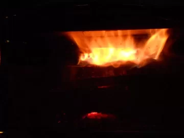

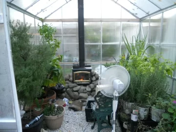

Ok, Arrow is installed in the green house. Installed new gaskets, double wall up threw the roof,(I cut the plastic polycarbonate and used sheet metal in it place. Now, I know this is not right, but I used what I had. Double wall all the way up and out. ya ya ya I know!!!!! But it is a 10x12 Harbor Freight green house, away from my house. I did sell the magic heat on e-bay for $112.50, now I have to dump 2 pieces of SS flue. I don't know what kind it is, but it is some very heavy pipe. Those burn tubes are going stong[Hearth.com] Arrow stoves, any good?
Be careful with that stove in such a small place. You may end up with baked petunias.
Im having a hard time right now keeping it warm, the space heater does kick on/off . This cheapie green house is very very drafty. I am working on sealing it up as best as I can.
Arrow is out!! Great LITTLE stove, just to small for over night burns in a cold green house. I replace it with a brand new Pleasant Hearth stove. Price was right just a three half hour drive each way.
Heating one of those green houses over night in chi town is gonna be a chore.
Neat set up.
I like the greenhouse, but as Oldspark says, it's gonna be a chore...
