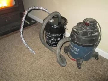

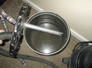

I've been using a variation of Mo Heat's homemade ash vacuum. The shop vac is just set up as a wet vac with the normal foam filter. I like to fill the metal bucket with enough water that a little bit gets sucked into the shop vac just in case. The water can also get a little funky. Best to flush it down the toilet after a week or so.
