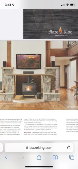

Give me exorbitant amounts of money and I’ll take the king and build a hearth like this one! But I’ll need enough to build the house too! It can look great in some spaces.
Nope the alcove looks great the stove still has comical proportions
