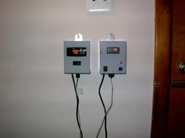

I have 2 older model temp alarms, I made these before Aauberins came out with their latest model.
I have a probe in my double wall and TC on the stove top.
My flue hi temp alarm is set to go off at 875::F, just about the rite temp to start turning the air down to keep max the
flue temp under 1000::F.
The stove top controller turns on the blower at 675::F and sounds the alarm at 725::F.
