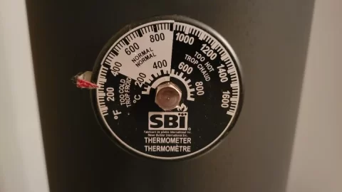

My probe thermometer at resting state

So, I have a lovely PE Classic LE. It tends to burn hot. I see posts on here about fluev emps and mine are always way over what others have. When I start a fire my flue gets hot fast (top down/bottom up it don't matter). In order to let my cold starts get going the thermometer generally gets up to around 1200° (I'm double wall). It then slowly goes down and stays at a solid 900° for the majority of the burn cycle and then dies down over the next few hours. My secondaries on this stove can really get going but not if I shut my stove down too early due to a high flue temp.

Obviously my flue Temps have me worried. Yet my stove burns well. I like what WoodHeat.org is saying and don't want to live and die by a meter. I'm wondering if my thermometer is reading correctly. It's installed by a WETT certified installer. At a resting state of room temp it does not go down to zero. It stays around 250°F. Could that mean it's off by 250°? Not a thermometer expert.
To install a new thermometer in the flue just pull this one out and stick another in the drilled hole?

Looks like your thermometer is off. Try to adjust it to room temp then reinsert and try again.

I found this thread due to the interesting suggestion of not (over)using flue thermometers. I totally get what they're saying. This morning, I had a complete panic thinking I had a chimney fire starting, because the therm has been showing higher temps the last few days. But this morning it went up around 1200 and kind of stayed around there between 900 and 1200, no matter what I did. It WAS a hot fire, and I had to point some fans at the stove to get it down below 650, if only for the sake of not wrecking the soapstone, etc. But I think I may have been more comfortable dumping more of the heat up the flue if I'd known the thermometer was broken. Once the fire was low I took it out and realized it was reading 450 at room temperature hehe.
I got the thermometer in September! Its SBI woodstove thermometer bought at Home Hardware. Useless after 4 months of use? I called the store where I bought it and he said, yeah they don't last long so theres no warranty or returns or anything. They're $40! Anyone have a better suggestion for how to at least have a good sense of flue temps without spending $40-80 every season? I have double wall so it has to be probe.
Condar makes a good flue probe thermometer, you can find it on Amazon for $40.

I strongly recommend getting a digital probe. There is about a 1-second lag time in temperature reading as compared to the approximately 1-5 minute lag time with an analog probe. With a digital probe, you get to see the effect of changing the air control setting in almost real-time. It will change the way you burn.

A K type thermocouple and a temperature meter like Auber sells would be the most accurate, and not much more than the mechanical probe. Condar thermometers have been accurate for me for decades cross checked against each other and with an IR gun.

Our old Condar probe drifted out of calibration over time. I recalibrated it this season with the Auber and it is still fairly accurate, but too darn slow.
I had the same experience. My dealer who came to check my stove, when I thought my fires were too hot, stated that my sbi was 200° too high. I switched to Condar, which is visually more appealing, but is relatively the same. Perhaps 100° lower but my stove does burn hot. I'm going to be looking into a key damper in the near future. I don't like blocking the boost air hole. I feel the bottom air intake allows for a better burn as it allow the fire to burn up.

I just tested my SBI probe. After removal from stovepipe it dropped to roughly 170 fairly quickly. It reads about 310-320 degrees when suspended in boiling water, so about 100 degrees high. Close enough for me.
I guess the next question would be is it 100* high at all readings.
Is it adjustable? If so, set it back 100º.

Appears to be adjustable. Maybe at some point I'll re-test it and adjust it. However I first have to determine if the 100 degrees is a constant thru the range. Somehow? Probably in the oven with a candy thermometer as a reference. Or there may be a better way...I'd like to test it all the way up to 1000 degrees. Hmmm...might burn the paint off the dial, idk..
in any case, she got hot at a point or two. Enough to make the probe warp quite a bit, maybe 1/2 " off straight _g. I'd like to know what cherry red hot temp of the actual probe is? I may have hurt my pipe and even my chimney a bit, Again, idk. Yet.
