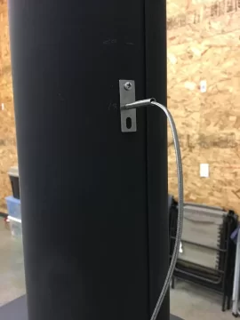

Too late. It’s in. Followed the directions and drilled the 1/8” hole which is pretty exact but loose enough that it slides out from the weight of the wire. I’ll build a spacer of some sort, thinking plumbers tape.

So the probe is more than 3" long?

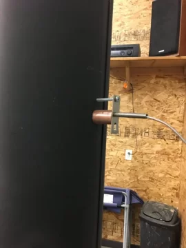

Yes, it’s four inches past the flange and intended for double wall pipe. So, one inch spacer is needed. How about a little chunk of copper? [Hearth.com] Auber install question

I removed that copper spacer. I found that the one inch required to perfectly center the tip really makes no difference and it looked hokey.

And it’s an all vertical flue, not sure if yours are horizontal. Very easy to verify it makes zero difference.
