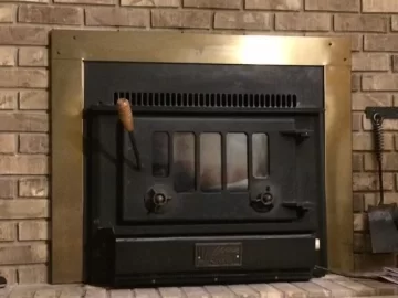

Hello All! I bought an older insert about a month and a half ago. It didn't have any name on the front and I didn't see any kind of information plaque on it anywhere. I stopped at a local chimney store to check them out and the owner of the chimney store said that this insert is an Aurora brand and that Aurora went out of business in 1983.
I wanted to see if anyone could identify which model this insert is. I would like to see if I can find an owner's manual online. If anyone has one of these and can give me some tips on how they burn theirs that would be great. I am okay at burning it, but far from an expert.
Thanks!

See my post in your other thread about smoking.
I just found out that my Aurora insert is model number 3L1X and it was manufactured by Diversified Products. I searched the internet pretty well and found absolutely nothing. I was told that when it was new it did come with a manual. It would be nice if I could find a .pdf file of that manual, but looks the odds of the are slim to none :(

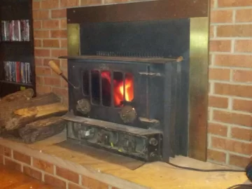

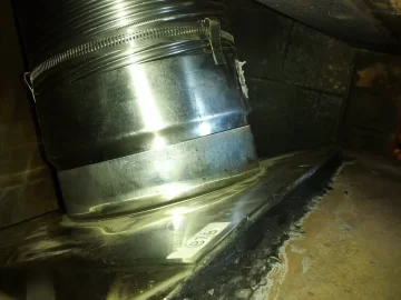

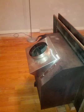

I ran mine last year as a slammer setup because I couldn't afford a liner. It is outdated and everyone here is going to recommend you run a liner. I just adapted a liner to mine and re-installed it last weekend- it works great! I attached a couple pics of it.

Is that an 8" liner? My insert has a damper on the back. Did you customize an adapter? I will scan the manual this evening.
it's a 7" liner. Mine had a flap too, I cut it off to make the adapter work. The aparter and liner came from Fireside Chimney Supply. I think the adapter was right around $100.

Sorry it took me a few days to get back to you on this; I was tied up with another project. Here is the link for what you will need to adapt a liner to the Aurora. It worked great on mine after I cut the damper off. http://www.firesidechimneysupply.com/flexible-liner-components/insert-boot.html

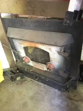

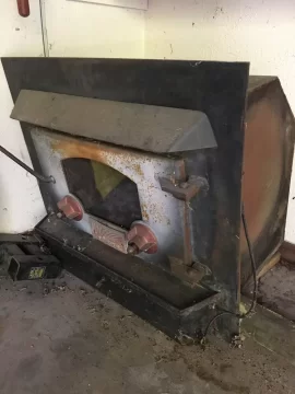

Hello! We purchased a house which had an Aurora insert left behind by the previous owner. They said they used it when they lived here 7+ years ago. It is not installed currently. We would like to install it and are not sure where to begin. Reading through the earlier information in this thread is helpful. I know this is a very old thread, but if the manual is still available, we would like to have a copy also. Additionally, our insert is very rusted and in less than ideal condition aesthetically. What do you recommend to recondition the surface? Thank you in advance and I hope someone still sees this post. [Hearth.com] Aurora Stove Model Identification[Hearth.com] Aurora Stove Model Identification
The stove looks like it has been ridden hard. Check it very thoroughly for damage from overfiring.

69_Eliminator I have a very similar Aurora stove and I have purchased the adapter from fireside to mount to the top of it. I used to be a machinist in a welder and I'm pretty handy and I understand how to mount that adapter to the back of the stove however what modifications did you make for the dampener on the stove to allow that to still function?
I have one of those inserts in great condition in storage. It was given to me for free a couple years ago. My brother and I have been kicking around installing it in a custom heatform fireplace in a rural property that our family owns. (Need to read up on the doability of that) It would probably only burn about 10 to 12 fires a year. As near as I can tell, unless you want to run it as a slammer, the damper system built into the insert would have to be cut off in order to attach a liner. I see no useful purpose to have it at that point anyway.
I have cut the damper off and have mounted and sealed the adapter onto it. You are correct. From what I've read when running the liner the damper that I have removed isn't necessary. The liner and insert are getting installed this Saturday. I'm anxious to see how well the insert performs.
