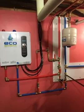

However I can open and close a valve and turn on the Buderus Oil boiler and use oil of the price is right. Maybe $2.00 per gallon:)
Pic 1 - EcoSmart 27kw using 3 - 40 amp breakers

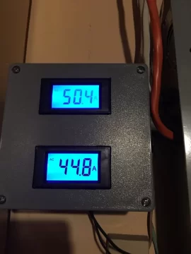

Pic 2 - 90 amp draw when taking a shower

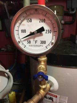

Pic 3 - Indirect tank temp in warm basement near pellet stove gets pellet heat to warm up from 6o to 80 Degs F overnight to save a lot of energy than heating cold street water at 45 degrees in winter time! ;-)

And how much did the instant hot water installation total cost you including equipment? I thought about getting an instant hot water system but from what I read I don't think I would recoup the expense for a long time. My oil furnace only goes on now when I need hot water 4 showers a cetera and I have to fill the tank twice a year was about 170 gallons each time.
170 x 2 = 340 gal x $2.70 per gal is today’s price is
$918 per year for Hot Water unless oil goes up.
That is $76.50 per month for 12 months.
I was using and paying about the same. Yes it did cost about $2000 including the $500 Eco Smart Hot Water Panel. I could have done it cheaper if I did more myself, I just mounted the panel and wired the electricity. The subpanel we put on for this panel was part of the workshop build but did cost.
I know it may take a few years to break even but if I retire and oil goes way up in price, I may be sitting pretty. :-)

Interesting about the 90 amp draw is:
I upgraded from 100 amp to a 200 amp panel and then I added the 125 amp subpanel on my boiler room for the EcoSmrtie.
I also put a 30 amp sub panel in the workshop off the 125 amp panel and
I had a 30 amp subpanel in the shed off the 200 amp main panel.
They had to put in a higher telephone pole for the new standard so I got brand new 300 amp TriPlex wires from the telephone pole to my house.
Therefore if you add up all my panels
200
125
30
30
385 amps
So I asked my electrician since it was all inspected and passed the local electrical codes, why can I have 385 amps in panels on 300 amp TriPlex wires. He said no problem since everything is never on at the same time!!! LOL
Or interpreted as 385 amps is the capacity of each panel added up. Twenty years ago in this house my total capacity would not be enough for the heater drawing 90 amps, all I had was 60! There were 4 15 amp fuses. After awhile I started buying resettable breakers, They screwed in like the fuses, but had a button in the middle that would pop out of tripped.
