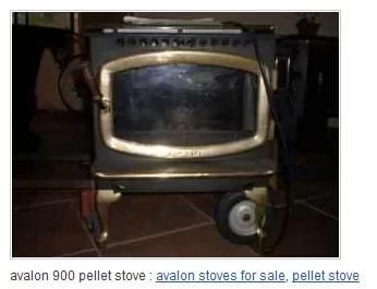

    Does yours look like the attached picture? It is an older model.
