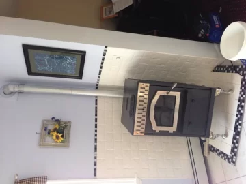

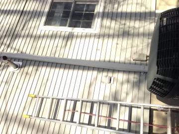

So the guy that I bought my house from set up his exhaust in a really awkward place for cleaning. I can clean the bottom of the pipe from below by taking the cap off and using a brush. But I can't really get to the top horizontal section. He put it right underneath the AC unit. So when I put a ladder up it's too far to reach. Does anybody have any good ideas about how to clean this horizontal pipe? Is the only way to clean from the inside by taking the pipe apart?

Can you twist off the top half portion of your vertical rise? I notice a break there. From there you can push it outside.
I see your difficulty. Too bad the installer didn't run the vent pipe straight out the back of the stove. My thought would be to use step ladders and some scaffolding plank to stand over the A/C unit. I'd run an eyebolt into the house framing to use as a safety to tie in a harness to prevent a fall.

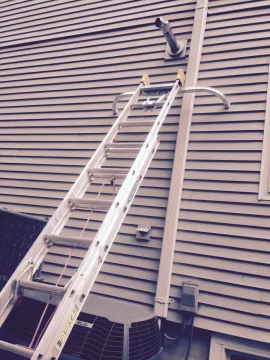

In the end, the guy I hired to clean the pipe because I couldn't get to it showed me how to clean it myself. He suggested using a ladder stabilizer which gets me out far enough that I can go over the AC unit. Nice guy! He definitely did not have to tell me that. But I appreciate his honesty.
