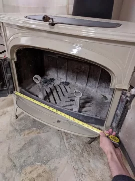

My wife and I purchased a house back in March with a 1986 Defiant Encore installed in the great room. It was moved there by the previous owners from a different room, and the company they hired placed it too close to the walls. Our home inspector told us that up front, and it was later confirmed by a chimney place when I had it swept. Therefore, we don't use it as burning down the house would be sub-optimal.

What model is this, the 2140? Is there a rear heat shield on the stove? With rear heat shield and a pipe shield plus 24" ceiling protector, the manual lists corner clearance as 17".

The manual I have (assuming it is correct) says Defiant Encore 0028.
Here's what the rear looks like. In the show room for the VC place I visited, they had a heat shield on the stove itself that looked like a detachable piece of sheet metal. However I'm getting the impression that's not an option for this model. They say to put it on the wall directly with an air gap.
[Hearth.com] Bad installation
The stove doesn't have the rear heat shield. It was an option for this model and it is possible that one from a new model 2140 would fit correctly. You might check here with the VC thread and under the Classic Stoves -> VC forum to see if anyone has a lead on one.
This stove puts out a lot of rear heat and has an unusually high, single-wall stove pipe clearance requirement of 24" instead of the common 18", thus the high clearance requirements. Another option would be to replace it with a stove that has lower clearance (and maintenance) requirements.

Yes, we looked at some Jotul models (F 500 Oslo and F 50 Rangeley), both of which have much better clearance requirements. That's definitely the easiest thing to do for us - it just comes with a price tag of $3500-3900 or so installed. That's why I just wanted to double-check that I'm not missing anything here before deciding which route to go.
I suspect whoever installed this just went with the more common 18" clearances rather than the 24" ... even though it's literally plastered on the back of the stove.
