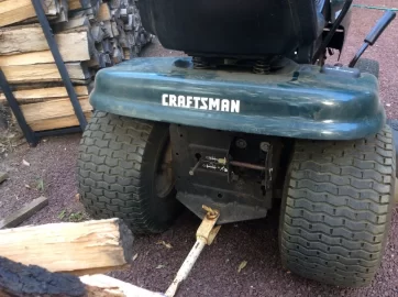

Hi all, I just got a new wood hauler and I'm looking to put a 2" ball on the back so I can tow my husky 22 around the yard. Please direct me to the easiest and cheapest way to get this done, thanks so much.....

I've seen them at tractor supply with a bolt on bottom appears as if u can just bolt it through the hole u have ur wagon hooked up to in pic

It's a pretty thin hole, but thanks....
Right behind the drivers seat.....drill a hole and mount the ball....or, can anything be done with the bagger mount (if you have one)
I have a similar tractor all the metal is the same thickness so not sure what would b sturdier to hook to unless u were to build something
If I put a ball in the hole that the cart is connected to, would that be too low for the splitter? It is probably 6" off the ground... Thanks...

Oh, I was referring to the size hole that the cart pin hoes in, it is not wide, definitely less than 1 ".....
I pulled my splitter around with a 1 7/8" ball through the hole like that for years through three garden tractors. I recently bought a two inch hitch receiver for the current one but the ball through the hole works just fine.

What I mean, was thru the body
Like Bart, I drilled out the existing hole on a Craftsman tractor to accommodate a 1 7/8" ball and pulled my 20 ton splitter with no problem. No need to get fancy or spend any more money.
Thanks guys, the hole is 1/2 in, I found a 2" ball with a 3/4 in shank for $16.99.....

Do it, i drilled another hole offset from the original, this way my lawn cart doesnt bang around as much, works fine on my Husqvara GT48xls
That HITCHIN' POST I linked to above does it all with no modifications to the lawn tractor. It's a direct bolt on to the pin hole of the tractor's tow plate and is stable because of it's anti-rotation plate.. I bolted a 2" ball to the top of it for my Huskee splitter, yet there is also a pin hole for the other equipment I tow behind (cart, lawn sweeper, spreader). It has built in hooks to attach the safety chains of the splitter/trailer/etc. I highly recommend it.

Yeah, that tractor doesn't have "high speed" even without a load. The thing I like best about the HITCHIN' POST is that I don't have to bolt, unbolt, or change anything when I switch from towing a the cart (pin) to the log splitter (ball).
Another thing the HITCHIN' POST does is raise the ball a bit higher above simply attaching the ball directly to the tractor's pin hole. The higher position keeps the splitter's tow bar closer to horizontal.

I have the 3 nib grass bagger, which has a larger mount than the one you have. I had a buddy add some beef & a hitch plate to it that will accept the ball. It works great when you can keep the splitter tongue level.

I like it thanks, I'm going to try BB's way first but if I don't like it, I'm going that way........I'm not hauling very far, just along the driveway, but I really like what you did.....thanks....
In the beginning, I had drilled out the regular hitch hole to accept the 3/4" shank on the ball. That worked but connecting & dis-connecting the splitter was a HUGH PITA because the tongue was at such an angle, the hitch coupler did not like to release.
The 3 bin grass bagger mount hangs on a shoulder bolt on each side of the tractor frame & attaches to the hitch hole with a pin & cotter pin. The whole mess comes off in 30 seconds. The only drawback is that I have the fat 22 x 11 tires, so I have to remove the shoulder bolts (and loose the bagger mount / ball hitch option) when I want to run tire chains.
I works great, beats the heck out of manually lugging a 700 lb splitter around my hilly yard.
