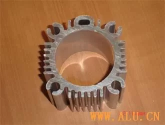

My own 'research' into aluminum heat sinks came to a dead end, but I found these images that might fire other folks' imaginations. The heat sink idea - leaving the flue the same brushable ID, unfettered with additional creo catching surfaces - still appeals to me... but I don't have a ready way of testing the theory.
Presumably, the cooling of flue temps would help precipitate creosote and (likely ?) slow the draft itself... presumably.
