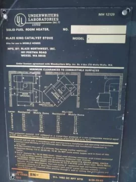

The manual or the metal tag on the stove (UL listing tag) usually has the clearance to combustibles and also the dimensions of the area that needs ember protection. Generally the first few pages of the book goes over this.
Here is an example of the tag your looking for.

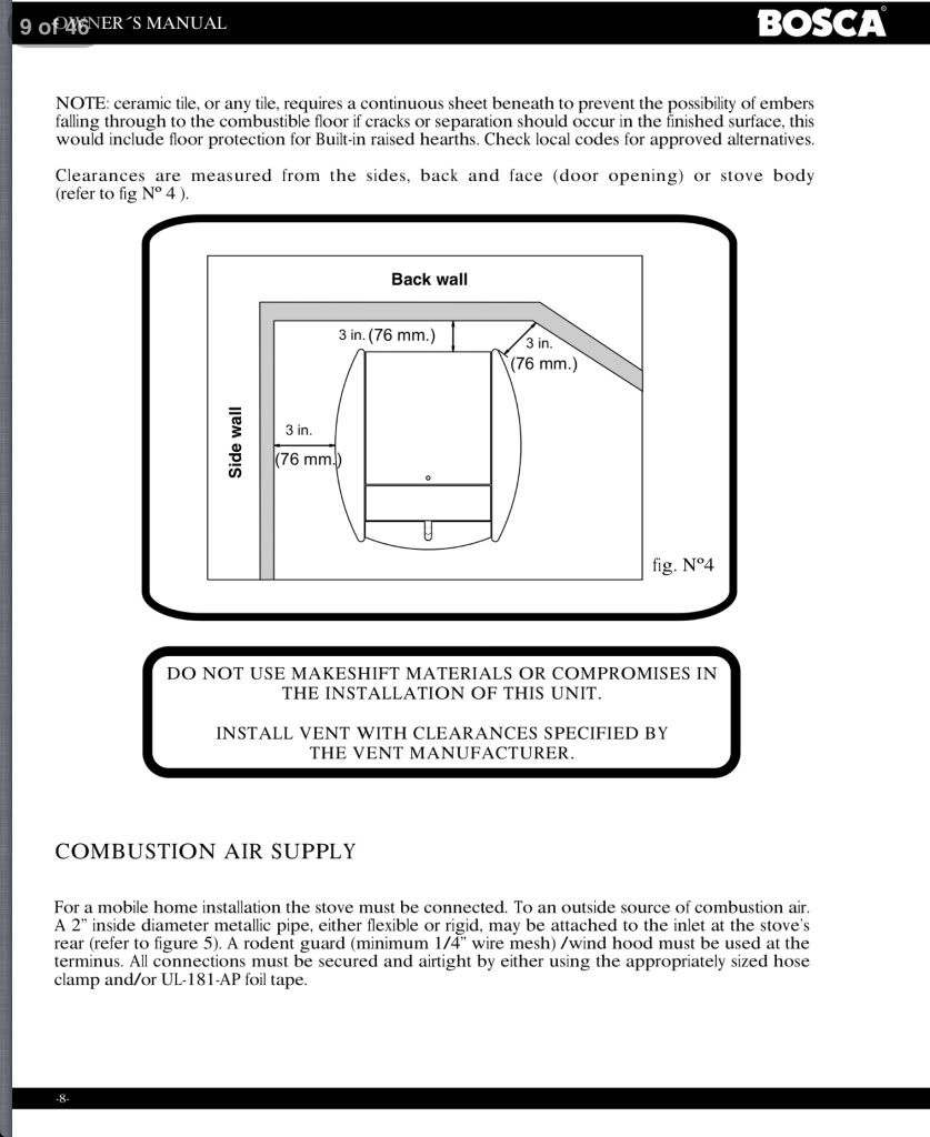

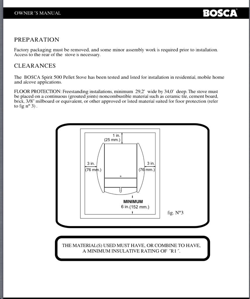

Here you go. I have a Bosca as well.
[Hearth.com] Base for my Bosca stove

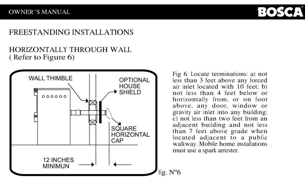

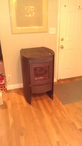

If that is an exterior door right next to the stove, you may have a tough time doing a "code" install there. Minimum horizontal distance to a door or window = 4' per manual.
