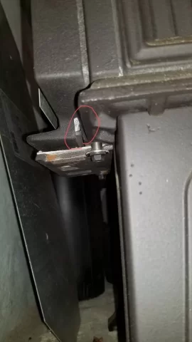

Problem: When I went to light the stove and with the door open (It didn't do it after door closed door guessing due to stove draft.) I saw some smoke at rear of stove. First I thought it was the secondary's and related to the new pipe addition. But unfortunately I think the rear plate lower on the stove is leaking. I watched the smoke come out. I did a smoke test and smoke sucked in when burning and door closed.
Zero Toys SmokPoint Air Flow Indicator
So this could be where my CO is coming from (at coaling) and cold air into the stove, but I wont know until after I repair stove. Going to try to seal it from inside but looks like a total tear down and reseal. Its close to the secondary opening but I closed them with the flash lever and the draw is to strong. Its a 2009 so Im guessing the sealant is bad.
