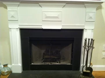

Pics please? But I believe you are going to have to go with a free standing stove.

Sorry for the delay. Let me know what measurements would be helpful.

Is it a gas fireplace or a prefab woodburning fireplace with gas logs? I had the latter, and the professional installers were able to put in the small Quad insert that I have.
The dimensions you want are height, depth, and width in the front and the rear. From the pic, unless it's deceiving, it looks like only a small insert would fit.

It's a prefab woodburning fireplace with gas logs in it. According to the manufacture's website, the front opening is 34.75", rear width is 19.375", depth is just under 14.5", and height is 21.5". I'm afraid that if anything only a small insert is going to work. If that's the case, what options (other than free standing) do I have? If I were to rip the current prefab out and install another, what are the chances that another prefab with the same rough opening specs will have room for a bigger wood stove insert?

Visually this looks like it wants a nice classic freestanding stove in front.

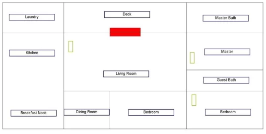

So here's a rough drawing of the downstairs living area. The red rectangle represents the current fireplace and the green rectangles represent air returns for the heat/air (the idea I had was running the house fan to help push that hotter air from the stove to other parts of the house that aren't as close to the living room). If I did go with a freestanding unit, how is that going to work in the current prefab, or will it? I would guess that the prefab would come out since it has a bottom to it? Need a little more info on how I would do this. Thanks!

The location is pretty good. Is the height of 21.5" the opening size? We need the height from the hearth to the top of the opening to see if a freestander would fit. If not, I'm looking into the Enviro Boston. We also need the dimensions for the clearances to the mantle side posts and face. This is the height and width of the black surround area for the unit.

The current opening size is 21.5". The height from the hearth (which is floor level) to the top of the opening is 27". The side stone pieces on the sides of the fireplace are 6.5" W x 27" H (goes to the top of the fireplace). The top stone piece is 7.5" H x 49" W
