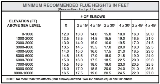

The thinner air at higher altitudes affects draft. This means a taller chimney is needed for many EPA stoves to burn properly. But some like the Woodstock Fireview and Drolet stoves, will work with a shorter chimney system. This is an altitude compensation chart for a Regency stove. The Drolets have a similar range. The Woodstock Absolute Steel has a minimum height recommendation of 15' at sea level.

Thanks! Does the flue height include the pipe inside the house and the chimney rising above? If I get a small enough stove, I may not need any elbows, but I'll have to get on the roof to measure the chimney height above the roof.
Yes, the connector pipe is included. Usually, it is measured from the stovetop to the top of the chimney pipe.
