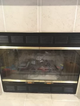

We are refacing our wood burning fireplace, no blower or anything. It’s model SC36 by Martin insert. We had a fireplace company here who said the vents on top and bottom could be stoned over and cause no harm by doing it. I question if that is true or not and was looking for feedback.

It is absolutly false. And dont let them back in your house
You have what is called and referred to as a zero clearance fire place, these metal boxes are built with vents to keep the outside jacket cool and allows them to be installed in wooden chases, any altering of vents can have dire consequences which can include burning your house down, theres not much you can do with that, but you sure can stone around any other portion of the fireplace, just not over any part of the physical fire place itself, before paying for any expensive materials or labor have the unit inspected, make sure the top outside jacket is not rusted / rotted and the unit can be ran safely ran

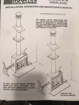

Thanks so much for your feedback. When the man was here he said he actually used to install these Martin fireplaces. I just happened to have the user manual still as in the pic of it you can see, one model has the vents and the other identical unit just has a solid front price in the picture. He was trying to convince us the vents were a gimmick back then and don’t really provide a function and that is why the same unit could be installed without the vents.
I would bet the one without vents has that chamber filled with insulation to keep outside temps down

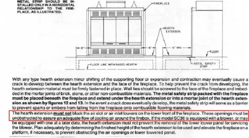

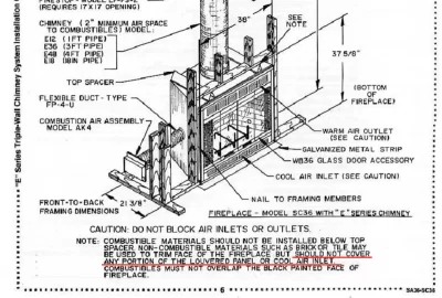

The manual has several warnings to not block the vents. Here are a couple examples. It also says to not block the vents in the trimming section. Is English a second language for this fellow?
