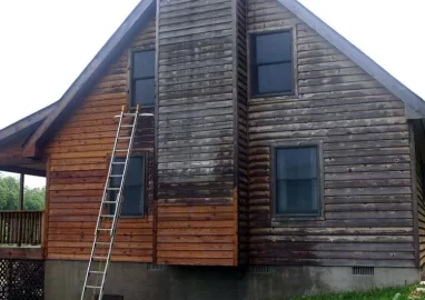

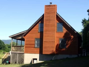

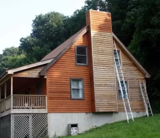

I've had good luck with Behr products. Availability is good, price is competitive, and it's a pretty good product. They come in three consistencies...transparent, semi-transparent, and opaque. Transparent won't last worth a damn. Opaque is like paint, covers everything so you see no grain...might as well just use paint. Semi-transparent gives a nice tint and good protection while allowing some of the grain to show through. Should last anywhere from 2-5 years, depending on exposure to the elements. I'll attach pics of a little weekend place in Virginia I refinished. I'll try to attach three pics of the west end of this place...pressure-washing what I started with, then applying the stain, then done. This particular color was called "Cedar Naturaltone", as I recall. That building was sided in cedar, but I've used the same stuff on SPF and even PT wood with satisfactory results. Rick

Rick thanx for your reply.. I am pretty sure I used the Behr product you described in your post last time and it has gone to hell.. I am considering an opaque finish this time as it is more durable and believe it or not my logs after 22 yrs. are still bleeding sap!! I started out with CWF way back and that was not very durable and I am not getting any younger so durability is a getting to be more of a factor now... If was to do it over again I would not build a log home especially not a pine log home... Live and learn I guess.. Thanx for the feedback!
