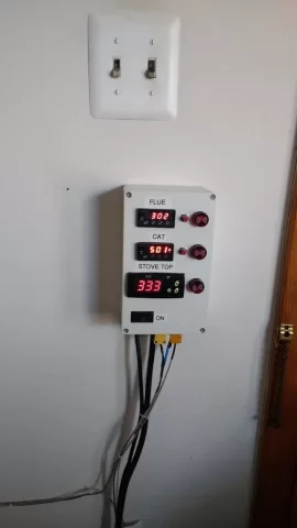

A few years ago I put this together for my BK. It monitors flue, cat, and stove top all with alarms.
Maybe a bit more elaborate than what you had in mind, but I find it quite useful.
