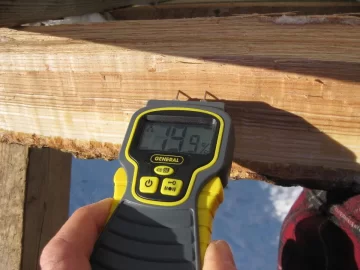

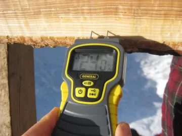

Just how much does cutting oaks in early/late winter measurably hasten drying time as opposed to a spring/ summer cutting ? I assume as the tree goes into winter dormancy and nutrient uptake stops, there is less sap and moisture in the outer layers, therefore taking less time to season, but by how much ?
Here are some readings I just took from a red oak cut a few weeks ago in early December. Readings are from outer sapwood (24%) and one from inner heartwood (19.9%). Both readings, if accurate, seem low for a green tree.
I just split a medium size split to get an accurate reading. Maybe my new meter is being too kind or is there a significant difference in moisture content in these oaks from season to season ? Would the readings be much different if I cut in the summer ?

what does your meter say those splits are once they've thawed out? ice doesn't conduct electricity the same as water does.
Never thought of that. I'll have to bring them in the house and retest. High today was 21 degrees.
I was going to say the same thing. Frozen wood will read low.
I have the same exact moisture meter, not sure from the pics but you might wanna try digging the prongs in a little bit further as I find that does make a tiny bit of difference. I know the oak is very hard and ya don't wanna break them but I haven't had any problems with my prongs.
