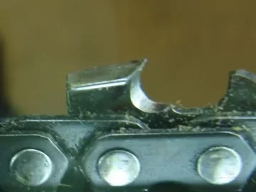

Sounds good! To me the shape of the raker is more important then anything else....This really will show up in milling, but makes a very fast cross cut chain. less drag less friction faster chain.
Makes sense to me. After I got done with the Pferd the first time, it cut some rakers a bit more than the others. Some it barely touched. That's why I think it cuts better now, the rakers are all at the same height now and they weren't quite that way from the factory. I also took the time to smooth out the little corner at the back of the raker that the flat file left. I've seen others that just leave it flat, but it seems they would be smoother against the wood if they were rounded, just takes a few minutes and is easy enough to do by eye.
This isnt a great pic of the raker but you can tell the shape of it.
