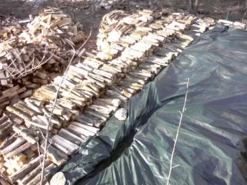

I use a single large tarp on the top only. Have no issues with rot at all and have very dry wood to burn. Spent 40 dollars for a 15x30 and is covers around 15 cords. I have a second tarp waiting to be used now. Need to stack a few more pallets worth to even up the piles.
  • [Hearth.com] Best way to stack and cover woodpile
The problem is that $40 tarp usually last one season or two at best. Methinks it is better to have something a bit more permanent rather than continually throwing dollars at the wood stacks.
