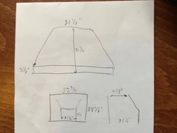

Thanks, begreen. The firebox dimensions are 33.75" wide x 28.5" tall x 21.5" deep. The firebox tapers, and in the back it is 21.5" wide and 14.5" tall. The chimney opening at the narrowest point, at the top of the firebox is 18" deep and about 24" wide. There are no mantel clearance issues.
