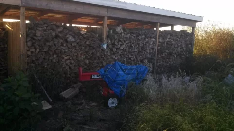

i have two of these- you can build them cheap - each shed is 20x12x8 so about 15 cords give or take per shed. I just use pallets for a floor and heavy wire mesh for the sides ( not shown in this pic) seems to work ok for me

I'd consider the roof without sides that was suggested above. Advantages would include lots of air flow and easy access to the wood from all sides. One problem would be snow blowing in from the sides, but that doesn't seem like a big deal if you are planning to keep the wood in the garage for a while before you burn it.

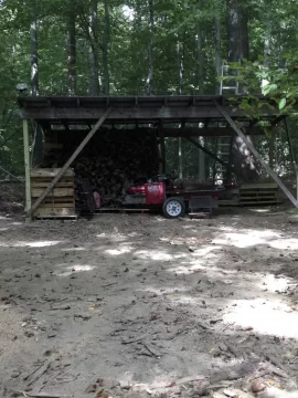

this is what i've seen as well on the hearth forum of one that looks great from another member. 24x12 with overhangs for roof to help keep snow and rain out. also back left open for easy wood out back side as well. nicely done. leaning toward something like this.

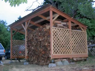

I built a cheap yet functional shed by sinking 4x4s 8 feet apart, and putting a roof on it. It made 4 8x8 bays. I bought prefab fence panels to go on the outside and between the bays. Each bay holds 3 cords.
That is the same as my design, each bay holds 3 cords. Our ground is not level so I set it on pier blocks with levelers.

Begreen, that's exactly what I planned to do, I cleared a 10' x 18' area, did you get the levelers at Lowes?
I got them at the local lumber yard but Lowes should be ok
