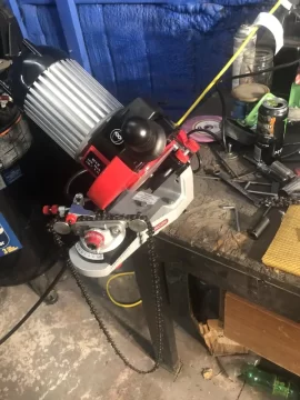

Agree as long as a Silvey is not included in the comparison. Heres my choice that works much better for me. Electric for the bench and rechargeable for the field.
  • [Hearth.com] better sharpener?

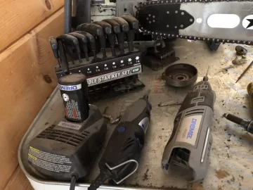

I've owned and used that HF sharpener for about a decade now. It's been perfectly adequate and I see no need for anything else. Prior to owning this grinder I would deliver chains to a local saw shop and for 6$ per chain he would grind off about 25% of each tooth! By carefully sharpening with the HF grinder I have been able to get many many sharpenings out of each chain and the quality of the sharpening is at least as good as the professional.
Maybe it's just practice. I feel like I could do just as well with a dremel device but the control of the cut angle with the HF grinder is much better.

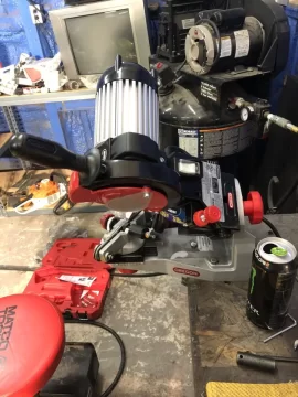

Just got this delivered today. My last one only lasted 1.5 years and broke. This is the 620-120 from Oregon. Under $400 on Amazon.
I can almost do 2 to 1 with the hydraulic assist. Love it so far.
