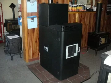

    These are the in stock options for us - any advice on which is better? Will be in the basement, heating 2250 square feet. HELP!!! Am also on a wait list for a Mt Vernon, but that does not look promising and am willing to give up on that.

    I guess it will be quite simple in this case with one question
    What is your budget???
    Big E runs you around $2,000.-- versus the Integra II around $4,100.--
    Both will heat aprox the same square footage. Hooper size is around the same on both.
    Styling and design, I guess the Integra wins in this case, but nevermind this is my personal preference.
    Efficiency is much higher on Integra 94% versus 81% on the big E.
    Thermostat functions - the Integra has much better control possibilities.
    On the Integra you never have to fool around with damper settings, its all automatic.
    I would say go to Website of both Products and download yourself the User-Pdf files.

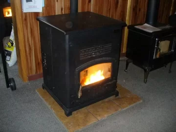

    The Big E is the all around best stove for the money. You will not be disappointed in it except the style needs to grow on you. Kinda looks like a tool box and not an appliance. I used one all last year as a running demo in the store and it was great. Upgrades to the the Endurance for this year, duct work to come.
    Call if you have any questions.
    Eric
    330-876-0200

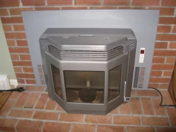

    Our reasoning for the cost was when we figured out how much it would cost to heat the house this winter at a conservative $4.50/ gallon x 1400 gallons = $6300!!! (my neighbor just locked in at $4.29 and has a $400 monthly budget!) It was less than that for the unit, install, and 4 tons of pellets and I already have a full tank of oil to start with. I have 3 levels each with separate heating zones so I will be able to shut down the first floor all the time and most probably the second floor 75% of the time, the basement is half finished so even if I keep it at 60 so the pipes won't freeze I think I will do well. Also the weekly maintenance on it is fairly minor, compared to other pellet stoves, and since I will be taking care of it and my husband will only be loading the pellets (99 lb hopper) that was a consideration too.
    Our second reasoning for the Integra is that 2 of my friends in-laws live in Seville Spain and, surprise!, this is what they own and have had for the past 7 years to heat the water and house, mind you to get to go to the bathroom you must go outside on the deck to get to the bathroom but at least they are warm in the winter :p
    Here is my Integra insert...
