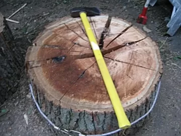

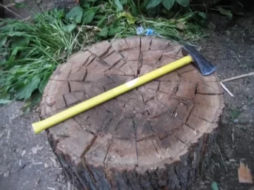

here is a picture of the bend, it's starts below the thicker weld joint and for kicks a couple of fresh cords it has helped demolish over the last 2 weeks. The round it is standing on was broken to that point with a sledge and wedge (if you can see the splits).

Boy I remember those wedge & sledge days...props to you for taking it on. Anyway now that I notice the bend it doesn't really look too bad...does it affect performance?
It does not affect performance at all, least that I've noticed, I also just talked with a neighbor whom I bought this maul at the same time with and he says we bought it about 4 years ago :question: , just doesnt seem that long to me but his time frame might be more accurate. I know I didn't notice the bend until 3 weeks ago when I started in on about the equivalent of 5 cord thanks to a neighbor downing 3 huge oaks. That said the wood is oak and breaking the bigger rounds (36-40") is rather easy sans an occasional knot and I'm young enough to consider it a "work out" so I enjoy the sledge and wedge bit (twist wedge only and 10/18lb sledges). I also just learned a new technique using a bungie cord that really cuts down on time when breaking big rounds, no more go fetch after splitting pie peices, genius idea! pic below, the round is broken into over 50 pieces I think and probably saved myself 30 minutes! btw the maul on top is the standard one I use for splitting to stacking size. If I knew of this bungie cord idea two weeks ago I would have saved myself an easy 10 hours I think.

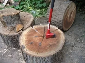

luckily I don't sleep much lol, basically I sledge and wedge a round that big into fours and depending on my mood (or if the big maul is near) I'll break it into eights with either the maul or wedge, then, with something that big, I'll break it once more with the big maul, into 16ths. Then you strap a bungie cord around the whole thing and start in on it with a regular maul. I start on the outer edge, after 5 blows you'll start laughing like I did in wonderment of why this alluded you for so long. No more picking up a big pie cut, setting it, taking off the end, picking it back up etc.. etc.., stays in place thanks to Mr bungie cord. the time spent usually bending and fetching is no longer wasted. With smaller rounds you simple bungie more together, ie bungie 4 8" rounds together. I only wish I knew of this years ago...! below is a picture of say "stage 2 and 3" of the bungie deal (slightly smaller round but you get the point I think).

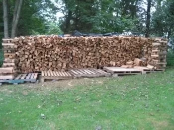

edit- I did the 3 rounds pictured in the earlier picture tonight to stack size and stacked them in about 3.5 hours (while stacking lots of other loose pieces). A round that size to stacking size probably ran me near 45 minutes each, at least, probably closer to an hour or more (can't say I time :) ) btw the one tool I dont mention but love is a 4 1/2' steel pry bar, great for breaking away the "strings" after the big splits/pie cuts!

Well fry my hide if that bungee cord isn't one of the cleverest aids to hand splitting I've ever seen...hell I'm going to try that when I hand split in the field this winter.
Morning, just wait until it saves you that much time. I was laughing in place thinking how silly I was for never doing it before. You'll enjoy it... I'm sure
For sure I'll use it cause when I hand split the wood flys all over and I end up tripping over it plus the time saved when it's all together and can be easily placed in the bucket...wicked excellent idea Sledge.
Sledge and wedge- you maul split like I do- keep the whole thing together and hit it just hard enough for the next fracture. I try to explain this to some folks new at it- you don't have to break it in half every time- and you don't have to always knock it over. Good pics.
thanks a lot s&w;. it'll save me time when i get down to the last 3 or 4 awkwardly shaped ones that just dont seem to want to stand up, not to mention all the chasing after big splits. i owe you ten hours. u know what, go take a ten hour break, my treat :)
