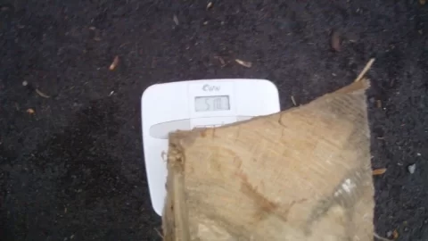

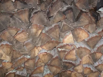

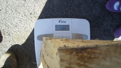

So, not a controlled experiment like some us around here run, but here is where I am with my control 9x9x21 or ~ 1 cu ft split.
Live healthy tree dropped and bucked mid August, split sometime around labor day, 1st and 2nd pics taken on 9/19, 3rd this morning. 7 pounds out of the 18 or so Sweep's charts say this split should lose by the time it is ready for the stove.

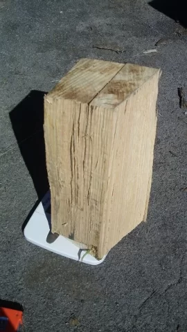

Well Solar I hope yours go well, and dries out these are my future overnighters, 21" L about 9" cut live tree Jan 2011, split stacked April 2011, like you said why not I have plenty of Oak. I do wish I would have weighed one and marked it.

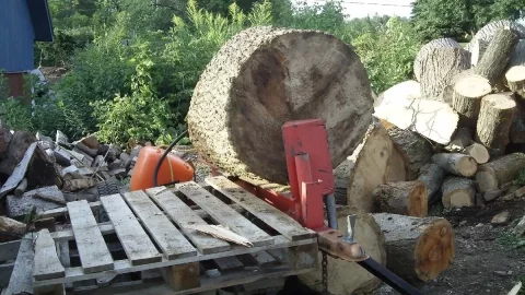

Sorry for the off topic question Solar but do you have a thread or any info on the electric splitter conversion, and how do you like it power and noise wise?
Standard 16gpm Haldex 2 stage pump with a 220V 5hp motor off a rotted compressor. Replaced an old Wisconsin gas after reading a Ramsplitter review and couldn't be happier. It is hiding under the Little Tikes swing re-purposed as a motor cover.

You gat a hydraulic lifter on that beast?

That's one big round! Serious BTUs in that one. :)
I wish. That cherry round and whatever that other one is sitting next to the splitter are the "stairs" that I roll the big ones up. The big Oak rounds were 40" in diameter and 20-22" in length. Felt them the next day for sure.
