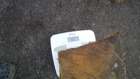

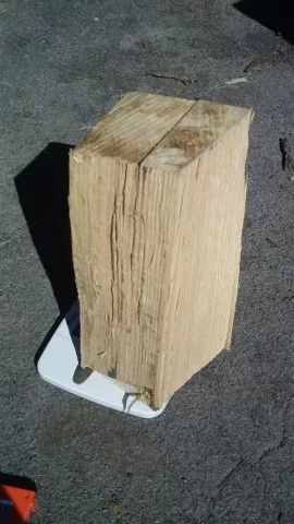

Dropped another 3 pounds in the last month or so. Still appear to be on a pretty steep part of the drying curve. Started around 60 pounds on Labor Day.

That's about 12 pounds of sap dried off in about 14 weeks......
Has it shrunk much yet ?
Doesn't seem to have shrunk much but I didn't mark the exact locations I measured on the split to begin with. Still seems right about a cubic foot.

Sounds about right. Sweep says this 1 cu ft split should be under 40 when it is dry. That is 20 lbs plus and I didn't weigh the split the first time until a couple weeks after it was dropped and bucked.
Slowing down but still moving along pretty good.

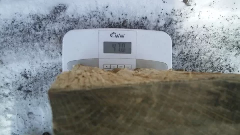

12/19 48.2 lbs
1/21 47 lbs
If we assume it is supposed to be about 40 pounds when dry:
first 60 days 39% of moisture on day 1
60-90 days 26% of moisture on day 60
90-120 days 15% of moisture on day 90
Percentages are obviously highly dependent on the actual dry weight and gets much more sensitive to that as the water weight goes down, but give some idea of what the drying curve looks like. From what I have seen so far, the assertion that big splits rot before they dry doesn't look correct. At the rate it is drying, it also seems to support the idea that the majority of drying is done out the ends. Lastly, I no longer buy the idea that wood doesn't dry in the winter. Maybe not as fast but there is still a good reason to get stuff split as early as possible even when cut late Fall.

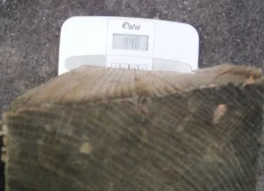

Who says wood doesn't dry in the winter? That is another 2+ pounds in the last month.
9/19 58 lbs
11/21 51 lbs
12/19 48.2 lbs
1/21 47 lbs
9/19 58 lbs
11/21 51 lbs
12/19 48.2 lbs
1/21 47 lbs
2/23 44.8 lbs
im thinkin my wood probably is drying more now than in the summer. everyday in 40's breezy and dry out. summer equals humidity for the most part here.
I couldn't imagine why wood wouldn't be drying all winter. The relative humidity is usually lower in the winter than the summer. That is a lot of water that has come out of that split. Nearly two gallons by weight now right?
Pretty close. Probably more if I had weighed it initially sooner. It's kind of interesting that something like 3/4 of the water is out of that big a split in 5 months.
Your thought about winter RH seems right too. Might not be that warm but it is dry and the wind is blowing.
