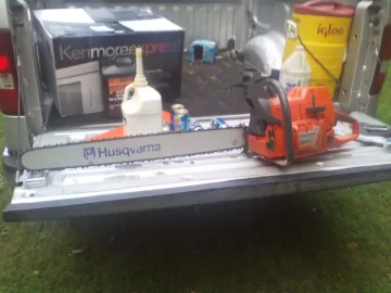

  • [Hearth.com] Bigger bar for saw?
Reactions: clemsonfor
