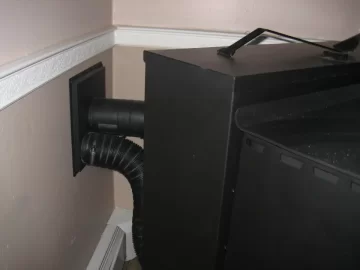

I guess the heat from the exhaust pipe keeps my OAK warm since so close together..
  • [Hearth.com] Bitterly cold weather and frozen OAK's
