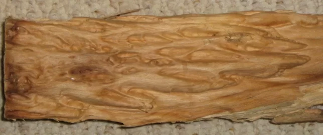

It smells very good when burning. It's as pleasant as black cherry. The bark held some of the rounds together when quartering to the point of frustration. Would not let go w/o being cut. Here's some of the underlying wood from that pesky bark. Very cool.

Gorgeous figure in that wood, Soundchasm! Is that split or sawn?
That's the bark side of a split after I peeled off the bark. It's 3-D. The best I can do when I find that stuff is put them to the side in my collection of "Interesting splits I have known".
