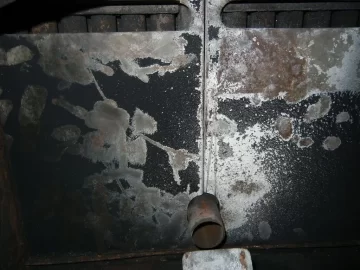

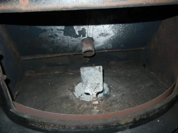

PM rona . He may have a downloadable manual. The exchangers have protective panels and they have to be removed before the exchangers can be cleaned.
Couple of pictures showing the panels, the device that holds the panel and it also cleans the tubes by sliding down the tubes. This the left side.
Thank you BIOBURNER for taking the time to send those pictures. I'll forward to them. I will probably be on here again at some point as I want to go see the stove myself to see if I can understand the working of the stove.

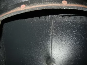

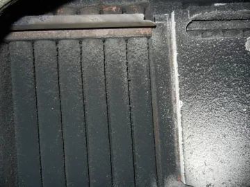

Couple pictures of the stove insides ready to burn.

Definitely need to turn down the exhaust fan. If pellets accumulate in the burn pot, will need to turn down the feed rate as well. Have fan low enough that ash remains in the burnpot, not getting blown onto the deck. Your pictures do show the heat exchange covers in place and the burn plates in place. If you have Bixby pipe (like Selkirk dt), then the surface of the pipe should be lukewarm to cool. Note that if you go to Bixbystoveparts.com, you can download manuals and instructions on how to replace various parts. These have very good pictures of the stove's components.
