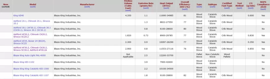

The point of such remarks is that the bottom end of the BTU output of the 20 and 30 boxes is about the same. So the 30 won't heat you out of the home more than the 20.
If space is an issue, take the 20 box.
Woody Stover
Dec 25, 2010
13,070
Southern IN
The 30.1 was apparently the low-output king...so to speak. 😏

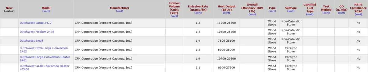

Hey, just find one of my backup stoves used, a Dutchwest 2460. I think there are a lot of em out there. Make sure it's not overcooked, though. Save ya about $3-4K. 🤗👌
