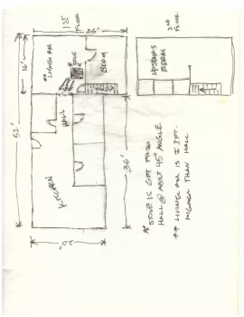

Here's the floor plan. I can blow cold to stove and down the hall with a floor fan. I just don't want another appliance sitting in what already is a pretty small room. I'm thinking if louvers were a viable option, someone would've piped in by now. Thanks for all the help

Would a ceiling fan in the stove room be possible? Get the hot air down, or at least equilibrate the air temp so the hottest air won't be stuck?
Can you put (3) in-the-wall fan units @ ground level in the walls of the small rooms between kitchen and stove room to get cold air back to the stove (creating a loop resulting in warm air traveling down the hallway to the kitchen)?

I put in the order for the 30.0. I hope it's not too much stove for the house. Also yes on the ceiling fan. I will wait and see if that improves the heat movement to the hallway. So you think blowing cold air at floor level into the heated space from a small room will create enough vacuum/circulation to pull warmer air into the hall and on to the kitchen? I actually have a in wall single fan NIB I was going to use elsewhere. One room is out due to all the utilites i.e. , H2 O and radiant supply, electrical and DWS. So really only have room for one fan.

Cool air is dense and will displace lighter warm air. It's worth a shot if required. Congrats on the stove. Surely you ordered the blowers?

Regarding the air movement - it seems to be the consensus that moving cold air works better. But you have to create a loop, otherwise you may simply create turbulence, mixing the cold and warm air at some point in your hallway and your kitchen won't get much warmer. If your rooms don't allow to create a "divided highway" (to the kitchen thru the hallway and back to the stove through those small rooms), it'll be tough.
If you have a basement or crawlspace, you could try a duct there, but you would have to insulate it very well (and keep the critters out of the insulation).
Do you have a ceiling fan in the kitchen area and the living room? My floor plan is different then yours in that my house is squarer, but this works well for me. So I have a reversible ceiling fan in my living room where the stove is and a regular ceiling fan in my family room area. I run the fan in the living room in reverse pulling air up the middle of the room across the ceiling and down the walls. The fan in the family room blows down to the floors. This cause warm air to be pulled through the top door opening between the two rooms and circulates the heat very well for my floor plan. I think it will help you pull that warm air down your hall way. Congrats on the 30, you won't be disappointed.
