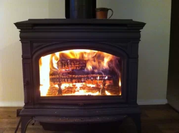

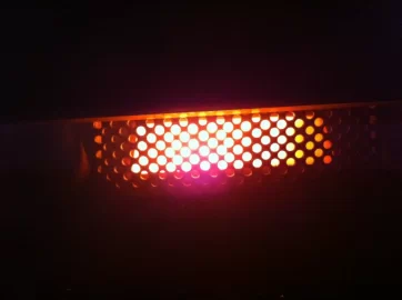

The Cape Cod will have a very nice fire view! The Ashford has a great cat glow! If you plan on sitting in front of it watching it like a fireplace the od is your baby. The BK's don't have much of a show, that's how they get unparalleled burn times!
I heat 2300 sqft with the Cape Cod and also have it located in a room with cathedral ceilings away from the bedrooms. With good wood, the thing will heat the entire house, no problem. I had to mess with fans for a bit to get the air flowing, but that's to be expected. The fire view is fantastic and the wife and I really enjoy it. I opted for the blower and would highly recommend it. It's quiet and pumps a ton of heat. I've never owned a BK so I can't comment, but people seem to love them. I get about 10 hour burn times with the CC, which suits my needs. Good oak or locust will get about 12. Good luck and enjoy!
