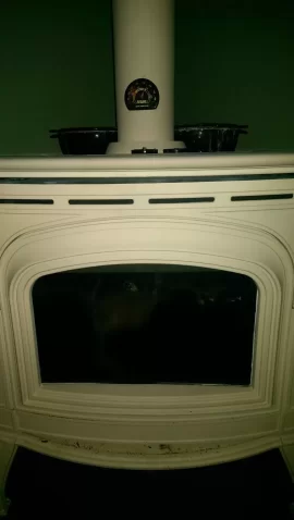

Hey guys. Had my Ashford since November. Wood is below 20% on the MM fresh splits. 16-18% on the outsides. 15' total rise centrally located in house. Rises 4' above peak of rancher. Out of stove, I got 39" before 2 45s, single wall in house, double wall the rest of the way straight up.
In mild winter area, average low single digits. Normal high in winter upper 30s. Thought the BK was right for me, PERFECT heat output. Was thinking increased draft was all I needed. If that is the case, why is my stove burning wonderfully hot with my current set up, stat set on 2.25, cat happy as a clam and I'm STILL getting the sweet, Carolina BBQ smoke smell rolling off the top, front of my stove. Chimney was just cleaned. Didn't even get a half gallon of black creosote from 3 months of burning. I do get some smoke spillage on hot reloads.

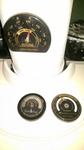

Over 500 on the outside of single wall is much too hot. That corresponds with 1000 degree flue gas temps. Compare that with 400 degree temps for me even with a cat probe much higher.

I'm very surprised that you are having such a rough time with the stove, but aren't willing to install it with double wall pipe like is recommended. It might not fix the issue completely, but installing like the manufacturer recommends is the first place to start.

Needing good draft isn't a theory. BK puts tons of money into testing their stoves, I assume they recommend double wall pipe for a reason. You might have decent draft? But If it smokes when you reload, and you smell smoke while is running, those both point to bad draft. Smoke doesn't leak if you have good draft, rather air is pulled in. I've never installed an Ashford with single wall pipe, so I can't say it will fix the issue for sure.
Why did your installer use single wall in the first place?

Agreed, need to just bite the bullet and get double wall installed either way. All of that makes sense to me. I suppose the stove can still get hot with poor draft, huh? It doesn't explain why the smoke is leaking out, though. If it's leaking out when the draft is pulling hard, single wall or double, something else is causing this problem. That's what I'm hung up on.
The installers of my original stove (VC Encore) were trying to get the costs down since I was installing EVERYTHING from scratch and looking at $5000. They said single wall wouldn't hurt anything and was significantly cheaper. Plus, it would also emit heat that would otherwise go up the chimney. Maybe this is why they are out of the wood stove business altogether now. Little did I know I DEFINITELY did not need the heat when you have a radiant, uncontrollable, cracked cast-iron wood stove. I had the pipe inspected by my chimney guy and left it in place. Modified it for the height difference for the new BK and I was back in business in November...

This was about 1 hour after a reload, all seasoned oak and pine with the stove on 2.5. I had it turned up because house was a little cold and we were anticipating single digits for once last night. This doesn't make sense. If I put my hand on the pipe up by the ceiling, it isn't scortching hot. I'm thinking that gauge on the pipe is picking up temps from the stove below...? Should I try to move it up and repost? Because there should be no reason my flue is 1000 degrees inside with the cat engaged and the tstat on 2.5 unless something is wrong, right?

The stove pipe thermometer is typically specified to be placed at 18" above the stove. 500+ is really high. What could cause that though? With the cat engaged I have never seen higher than 800 even on my full throttle for an hour burn out routine that BK recommended.

A campfire has no draft but gets plenty hot and the smoke temperature above the campfire is really hot. You can't verify draft with a thermometer.
