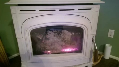

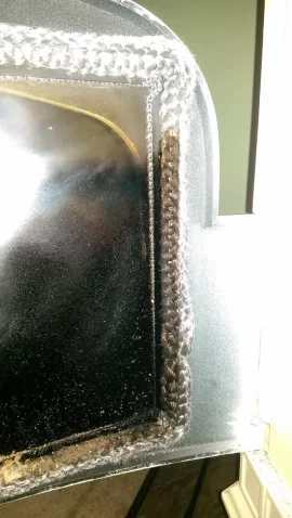

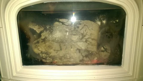

Ohhhh! Ok, sorry. Little slow. My gasket appears to be all 1 piece!
Can you take a close up pic of the gasket specifically in the area between the hinges?

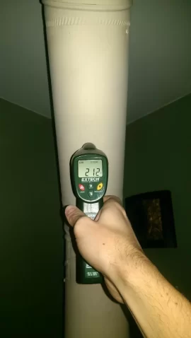

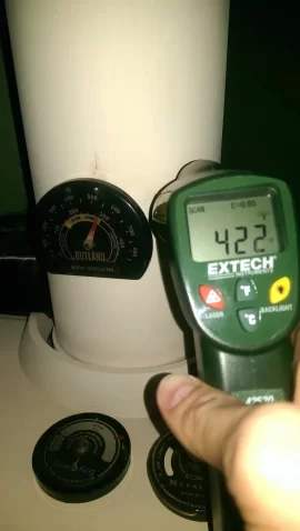

Over 500 on the outside of single wall is much too hot. That corresponds with 1000 degree flue gas temps. Compare that with 400 degree temps for me even with a cat probe much higher.
A half gallon of creo after three months seems high too.

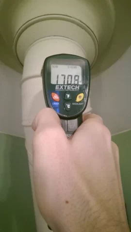

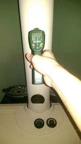

Hey guys, so this high temp alert was alarming to me and I decided to make sure that gauge is right. Appears to be reading 100 degrees too hot. I also included photos of the rest of the inside of the run,middle and upper. Let me know your opinions...

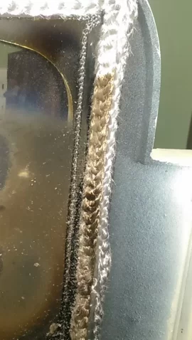

Thanks. Can you by any chance get in closer to the section right between the hinges? It looks like the gasket in this area is bunched out on the inside of the knife edge indent, and the outside appears blackened, at least in the pic.
Is that any better at all? I don't understand your description about knife edge, but am interested and was highly suspicious of a gasket issue here since this is directly under where the odor escapes
A little further down? The area I'd like to specifically see looks to be about 4" above the bottom edge of the door.
