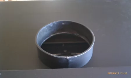

I can verify that one hole was predrilled in the front my collar and if the others were predrilled then they were not at the 1/3 points. Also, the hole looks HUGE. Way bigger than the normal stove screws.
They would be "huge". It's not meant to have the the screw threaded into it, instead the screw is meant to pass through the collar and into the stovepipe.
Well yeah, and with it being huge you should have an easier time hitting it.
I wonder why they only had one hole to begin with?
