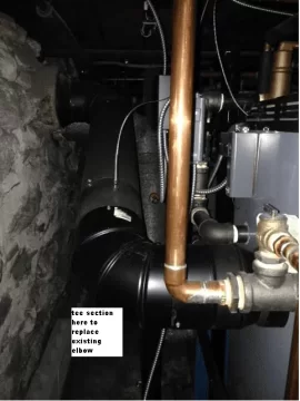

Tee section to attached to very short section before it hits boiler flue collar (hence need to add crimp on tee section). top straight section of tee into straight 6' section of stove pipe to flue. Bottom straight section of tee will have a cap fitted over it and will serve as my clean-out port straight up into the six foot section where the majority of the ash and crud gathers over the heating season. Currently have 90 deg elbow between six foot section and boiler flue collar. All has to be disassembled to clean mid season. PIA. Removing cap to pull debris out in straight sloping direction I hope much easier. Only slight concern is turbulence affect on draft of immediate 90 deg turn based upon tee versus 90 deg turn but via rounded elbow.
Here is photo. Anyone see issues with putting tee here and hence clean out? tee on clean out end to be covered with cap with three sheet metal screws.

That is almost identical to my setup - I have a T where your elbow is. It makes it very easy to keep things clean, by popping the cleanout cap off. You can get both ways - up the pipe, and into the boiler with the right kind of angled cleaner thingy or even just using a gloved hand. I even have the same slight incline for about the same distance, and the same 90 into the bottom of the chimney (mine has a baro there though). Probe location is very similar too. I find most of the ash settles in the slight incline - very easy to get to. Also easy to plug a piece of sump pump hose onto the end of a shop vac wand and get it all kinds of places.
I just went & looked at mine & my memory was a bit faulty. I do have the female non-crimped T end, fitting onto my boiler. Mine just barely fit onto my boiler collar, over it. Very tight fit, I remember that part now. I was worrying it would split the T at the seams when I was putting it on, so after I got it on I put a couple screws into it to hold it in place (the collar was very hard to drill pilot holes into also, that memory came back too). I would try fitting the T onto the collar before you get crimps done - I was sure mine wouldn't fit at all the way it was until I actually tried it. There are also strap type collars you can use to connect - that was my backup plan.
seems like you guys are just a few steps ahead of me! I finally caught on though. Yeah, by the end of the season that incline section is full of ash and very fine crud. Probably impacts draft slightly as it builds thus reducing pipe diameter internally. Anyhow, next time I shutdown for cleaning I'm going to implement. Tired of trying to reach in from inside boiler through elbow into the section. Scraped up my hands and elbows many times doing this. With respect to the female in attaching to the collar I had originally done that on install. Piece was EXTREMELY tight over collar and when it rusted out I had a helluva time getting it off. put a 5" reducer piece internal to collar instead of over. Distance from tee to collar just a little too far for direct tee connection so easier just leaving internal reducer in collar then short section of 6" pipe from there to tee. Thanks for the input guys!! I always get answers and excellent feedback always!

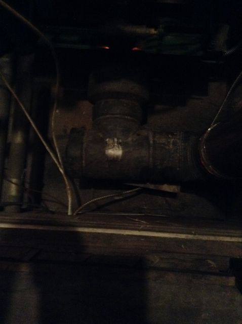

A little dark but here is what I installed last year, I also picked up a small inspection camera from HD, after remove the cover and clean, I send the camera up for a quick look....

I just re-checked my install thread. There is a pic of mine, in the first post on page 2.
Thanks guys for the photos. Exactly what I am looking to do.
