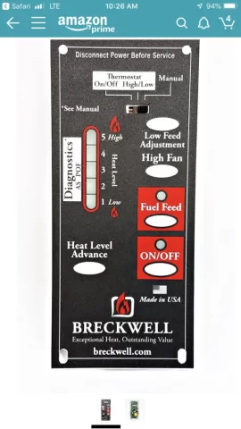

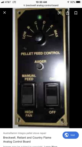

The control board dictates wich auger motor can be used. If you have this board [Hearth.com] Blackwell P24 Auger motor replacement
You will need the new wire harness and a 1 rpm motor.
If you have this board you will need a 4rpm motor

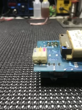

The original board for Breckwell p24 has a 6 pin molex connector. The new board has a 10 pin molex. So unless sombody allready completed the harness upgrade or it needs to be changed. The auger motors are pretty much the same, the diff is in the gearbox. Some pics of your plugs and harness we should be able to see if you need the harness or not

No thats the 10 pin.
6pin looks like this

As for your performance question.
The board you have now is programmed to use a 1rpm auger motor.
The board you replaced uses a 4rpm. It will not play well with your new board. It will over feed the stove and could be a fire hazard
