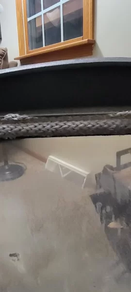

Where is the seam in your gasket? At the same place? (Puzzled why an air leak would exist when the dollar bill test is ok - suggests a channel in the gasket rather than a leak because of warped door or flattened gasket...)

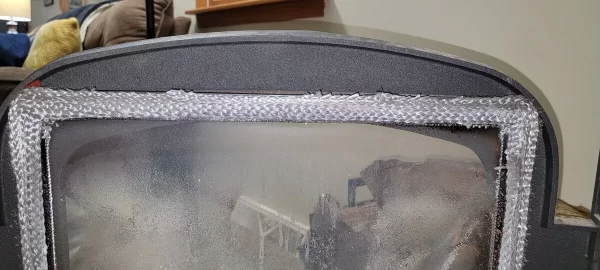

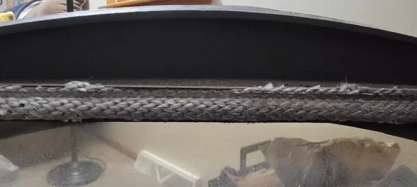

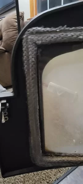

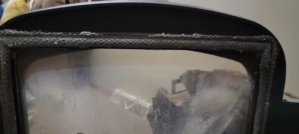

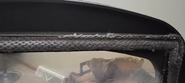

20220113_183556.jpg 20220113_183552.jpg 20220113_183549.jpg 20220113_183532.jpg 20220113_183443.jpg 20220113_183447.jpg

I can't make out where the seam is, but the top of the gasket seems to be too low. I.e. your door needs to be hung higher; the impression of the knife edge in the gasket is not centered enough.
Not sure how that correlates with smell from a corner though.
I would agree that it's not centered. But The bottom knife edge is similar. So if I adjusted the door for the top knife edge to be centered it would throw off the bottom knife edge. I'm not as worried about the smoke smell as I am the air leak sound. I have learned to live with the smell. Just not sure if the two issues are related.

Ok. I couldn't see the bottom well. If that's the case, the gasket could have been installed better, imo.
Indeed, if air is going in at a rate you can hear, that's a problem (for burn control and for the cat).
I don't see evidence of that on the door. You wiped the glass though. The gasket is clean though.
I can't hear it from here (...) but I'd see if you can confirm where it rushes in using smoke; see if it gets sucked in.
Also, have you checked that the window is still without play? Put two flat hands, one inside and one outside, see if you can move the glass?
