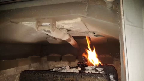

Send me some pictures. ...
An interior shot would be great. Nice looking guard dogs! The door on your stove is a bit on the rare side. Those old Princess models did well with 8" chimney too. Where in AK do you reside?
Lol! Thank you! Okay, here's an interior shot... I know I need new bricks, they're on the list.
