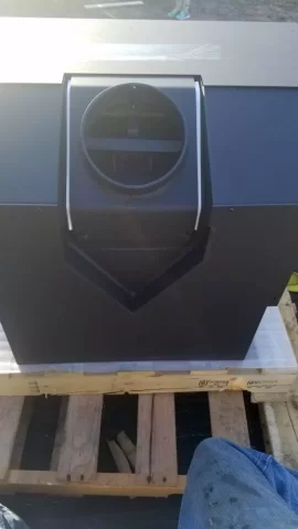

Installed the Siracco 25 this weekend, was one of the easier installs thanks to Blaze King's flue adapter, you install it first on the liner than back the insert into the fireplace, reach through the damper and grab the adapter and then mount it on the back with two bolts. The most worrisome part of the install was making sure you have the flue adapter at the right height, you have some wiggle room but you want to be close, and for sure you do not want to be short!
Anyway I took plenty of pictures.

What's up with the wiring around the thermostat. Looks like they have white connected to black connected to white? Why is there even a splice there?
So is this thermostat located up front directly connected to that knob or is there some wonky linkage?

Don't mind that, that picture was taken while it was still in the wood crate, those wires are for the fan and got cleaned up on the final install.
Correct, connects directly to the tstat, nothing wobbly, very secure so I know it is not slipping, I verified it is hitting the high and low stops on the tstat.
